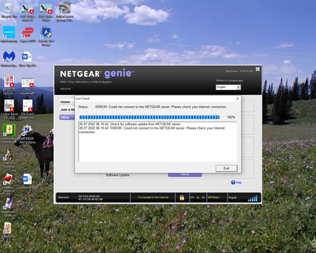

Unable to update AC1200 USB Adapter Software
Just installed the AC1200 USB WiFi adapter and when trying to check for software dates thru the Netgear Genie I get the following message The software was what was on the disk with the adapte...

Finally, you might like to investigate the use of Alt + Print Screen in Windows. It gets screen grabs of the top window without throwing in extraneous details that might contain sensitive stuff. The results are also easier to read.

The "Genie" software version is 1.0.0.39 and I had followed the install instructions by installing the software before attaching the adapter. I did not install any other software. Since 1.0.0.39 seems to be the latest, I guess it's up to date.

I wouldn't use any sort of genie to check for updates. It is unreliable. As schumaku says, do that on the support pages for your device.
This shows that you do, indeed, have the latest:
