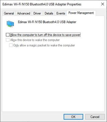

    2. Why is v3 goes to like a sleep mode, this is a desktop, not a laptop and I find no setting in the v3 config for any type of sleep mode, nor do I find any setting in Xp Pro that would put the USB ports to sleep and I find no such setting when going into device manager and looking at USB functions  ? ? ?
    That has nothing to do with the USB adapter. It is a setting in Windows.
    I have no idea how to do that in XP. (You are dicing with death if you allow anything on XP to connect to the Internet.) But this is where to look in Windows 10:
    Wifi adapter properties

        TeamCorvette wrote:
        As to dual band going to sleep, being this is a desktop there is no setting for power that would put dual band or any USB modules into a lower power mode
        Where did "dual band" come from? You mean the USB device?
        The idea that "there is no setting for power" on a desktop is incorrect, as my screenshot showed.
