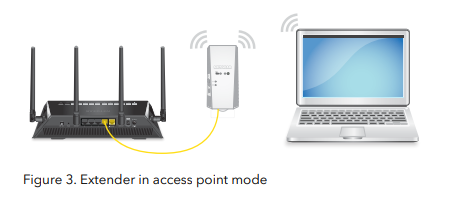

Using the extender in Access Point mode with a LAN cable between your router LAN and the extender Ethernet port?
Here the router will assign the extender a LAN IP config from the router LAN DHCP server.

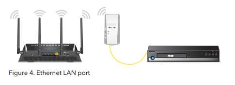

Using the extender as a wireless client with a LAN cable to a device to be Wi-Fi enabled?
Beruthiel wrote:
Recently I had to reset my router, so I had to redo the connection.
In the wired access point mode, there is nothing to re-do. Just establish the router LAN to the extender Ethernet port connection, and cold boot both devices.
