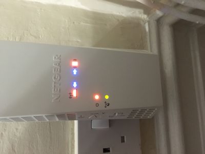

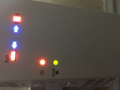

- doubleudeeNov 11, 2023Aspirant
The lighs are off when I power it down (naturally) and then all come on when I power back up. When I press the 'reset' button for 15 seconds, nothing happens, no lights go out, no lights flicker or dim or even change colour?
Here's some pics of the lights
- plemansNov 11, 2023Guru - Experienced User
red power light tends to indicate a corrupt firmware.
You can try recovering it with tftp or nmrpflash.
are you on windows? if so, follow this guide
