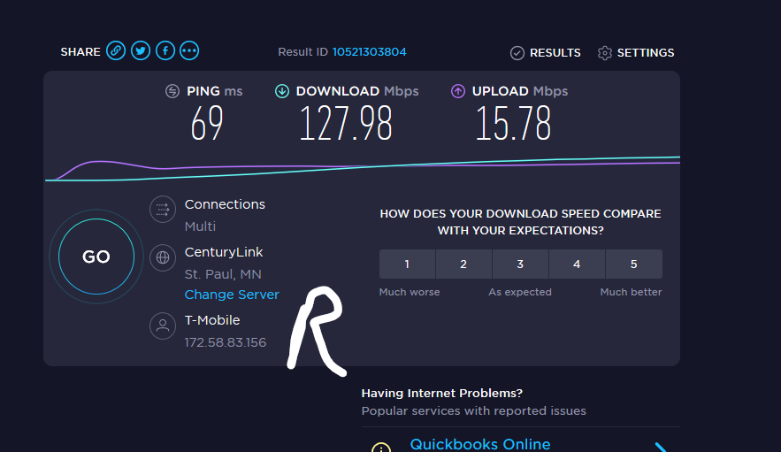

I get totally acceptable (for my situation) speeds directly from the hotspot, and then also from the router. Problem with the sotspot (the original reason for my post), I'm trying to find an alternate way to log onto the extender, as when I try now, I just get an "unable to connect"
page on my browser. I wanted to see if it needed a firmware update.
Speed results from the router
Speed results from the Hotspot device.
