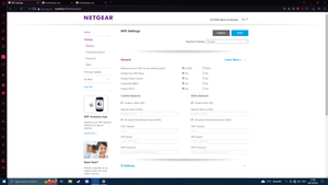

AX1800 (EAX20)'s 5GHz does not work for Ethernet nor Mobile.
As one can see, I have set the ethernet to 2.4GHz. If I set this setting to 5GHz however, the computer that is connected to the Extender via Lan-cable just ceases to connect to the Internet. Changing...

got a screen snip of the status page?
Simula
Oct 10, 2023Tutor
Not rn. Not home. But everything's fine according to the status pave. It's just that 5ghz doesn't offer any internet ( I can still connect )
