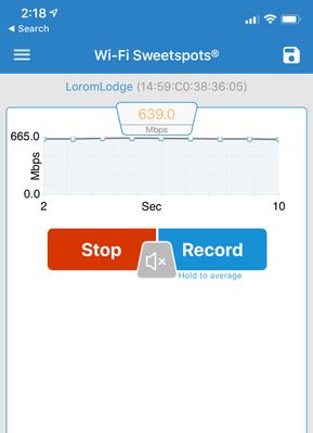

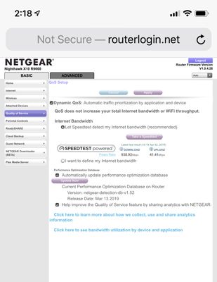

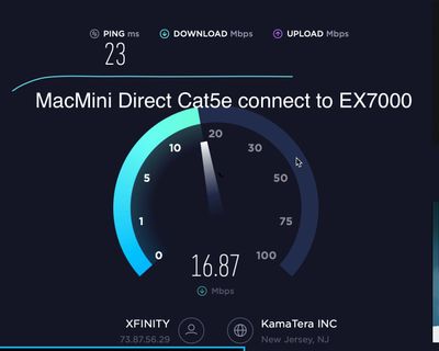

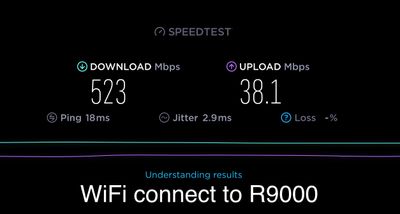

I also have not been pulling any more that 17MBps through Speedtest from the EX7000. I have screen shots attached of:
1. Internet Speedtest run from Netgear R9000 connected to modem - 938MBps
2. Wi-fi Speed test from same room as EX7000
3. Internet Speedtest from R9000 to device in the same location
I have also connected my Mac Mini directly to the line that the EX7000 is connected to the R9000 by, and have pulled Speeds over 600Mbps. Once I switch the Cat5e line back to the EX7000, and connect the MAC Mini directly to the EX7000 via another Cat5e line, Speedtests drop back to 16-17MBps.
All that being said, I have not seen real-world performance issues, i.e. no lag on my 4 Nest Cams, 4K streams ok. So I’m wondering if it is some sort of software glitch in the EX7000, that impacts Speedtest specifically? Possibly to do with QOS maybe?
