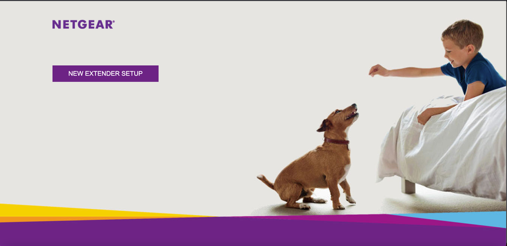

Can't login to the EX8000 admin page
I've got an R8000 as the main router, but it isn't in the ideal location for the best signal coverage.
I've bought an EX8000 that would hopefully help with the weak wifi coverage,but when I set it up as an Extender, I was only getting 60Mb download speeds (with 600Mb being the max my service is rated for).
Instead of using it as an extender, I've decided to use it as an access point, since there is an ethernet line going to the R8000.
This works, and I get very high download speeds if I connect my devices to the EX8000 instead of the R8000.
Now that it is up and running, I cannot log into the admin page for the Ex8000.
I'm not referring to forgetting my login name/password, when I connect to the EX8000 it always brings me to the "NEW EXTENDER SETUP" page.
See screenshot.
Is anyone else seeing this issue?
Thanks

    What happens if you walk thru this setup wizard and still configure AP mode on the EX?

      I've already done that in order to get the AP configured for my network.
      Acutally I've done it twice and still end up in the same place.

        Be sure FW is updated on the EX. Connect to the EXs IP address as well given by the host router.
  • Push and hold the Factory Settings button (located on the side panel) for 7 seconds. Your range extender resets. Open your computer or mobile device's WiFi menu and connect to the extender's default WiFi network, NETGEAR_EXT.

      I started this whole process by resetting to factory defaults, then went through the Extender setup (3 times). It did not improve
      my wifi speed. Reset to factory, then setup as AP, which works ok, except that I can't get to the admin page.

    did you run through the access point setup?
    Because the page you're on is the starting page for new setups.
    If it was setup prior, did you factory reset it before connecting it?
    Here's a video of how to set it up in access point mode.
    https://www.youtube.com/watch?v=txCVRw3rkbU

      My EX8000 is now running as an AP. I'm a bit disappointed that it doesn't work well as a mesh extender. The reviews I read made it look like the hottest extender out there.
      I had gotten confused at the "NEW SETUP" screen.
      All is good. Thanks everyone!
      • plemans's avatar
        plemans
        Extender mode and access point mode are 2 different modes.
        1 allows the use of smart roaming protocols because it works as a mesh devices.
        The other it funcitons as an independent device as an access point.
        Not always simple but access point mode tends to be much faster and have the 3rd band freed up for usage.
