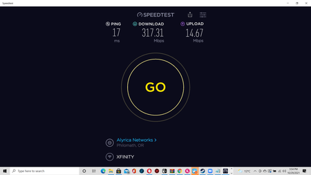

theimortal1974
Oct 29, 2021Aspirant
connected extender with all green lights and strong connection barely the speed the router gives me
i bought this extender. it's halfway between the router and the laptop. i got this because my laptop is behind a wall and has unstable internet from router. i got the extender instal...

theimortal1974
Oct 30, 2021Aspirant
why i got it is though i do get fast speeds from the router it's unstable at times because of the big wall between me and the router. though i'm testing somethings out before i return the extender tomorrow. i had my router in a little cubby (open in the front) and not sitting out in the open and now it is in the open. i'll see if that makes a difference. thanks for your help.
- theimortal1974Oct 30, 2021Aspirant
which of these would you recommend if i live in a one bedroom appartment (though my office is near the front door in a corner of the appartment) and even with ethernet cable i only get 500 Mbs speed?
https://www.bestbuy.com/site/searchpage.jsp?id=pcat17071&qp=storepickupstores_facet%3DStore%20Availability%20-%20In%20Store%20Pickup~600&st=mesh+extender- theimortal1974Oct 30, 2021Aspirant
i just realized the speed i'm getting far from the router and behind a wall is the same speed i was getting with ethernet connected next to the router. that doesn't make any sense.
