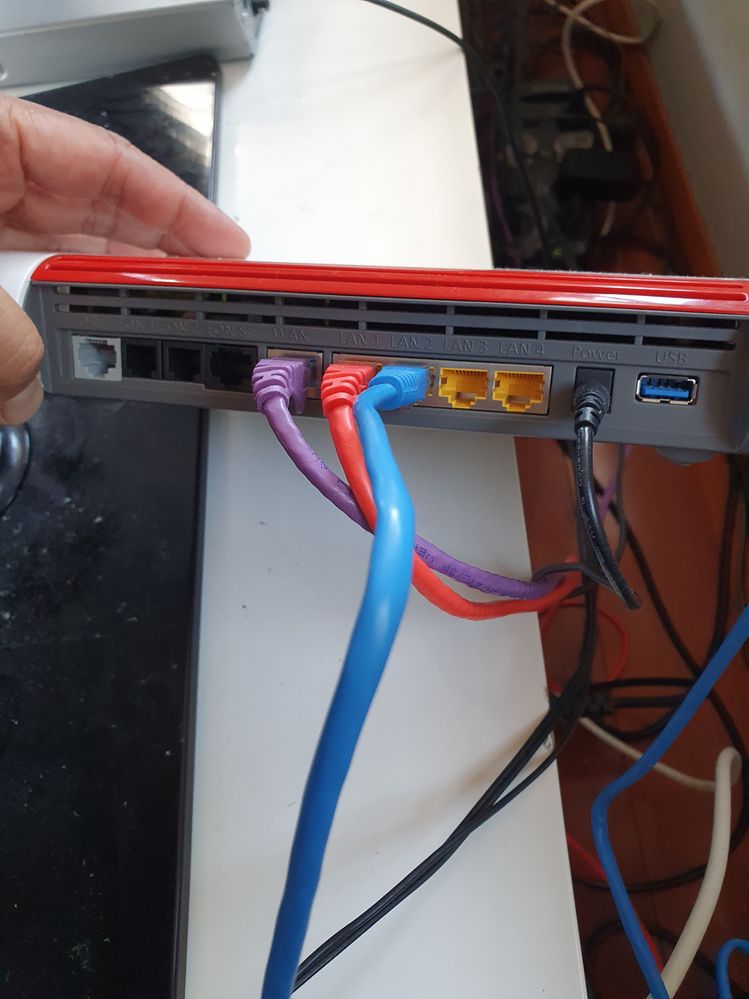

1) I plugged a LAN Cable into my FritzBox 7590, and the other end of the LAN Cable went into the 'Internet' port of the D6300, then powered the D6300 up.

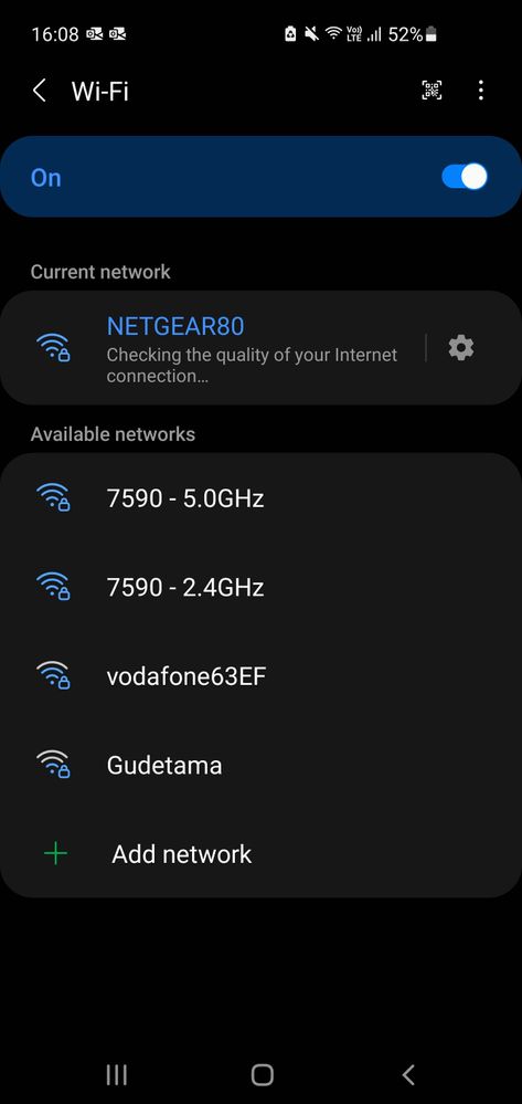

2) From there, I used my Samsung Galaxy S10 and joined WIFI network 'NETGEAR80', and got into the Genie App Interface.

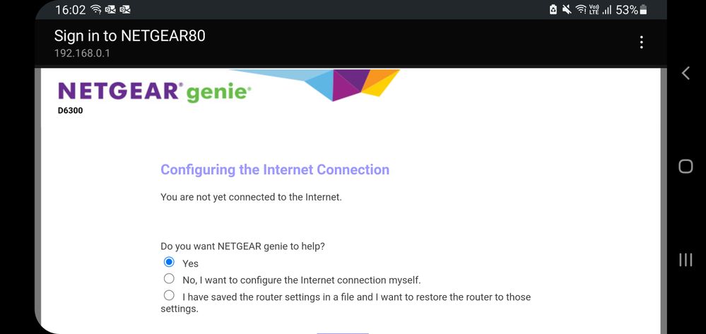

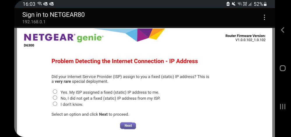

3) Followed the onscreen instructions, it said there was 'no internet' and asked if I would like Genie App to help establish a connection, I said 'Yes', selected my country, and went through the sreens, that didn't work, so I tried providng the MAC Address of a computer that is already on the network, all that option got me was a message on my phone saying:

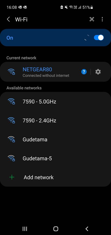

Netgear80
Connected without internet
I can see the D6300 in my Fritzbox interface, but can't get into the Genie app by clicking it from there.
