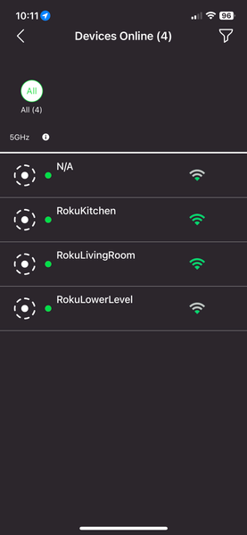

I have a T-Mobile Home Internet gateway that sends out both 2.4GHz and 5GHz bands on one SSID. I setup my new EAX12 Extender yesterday with the help of a Netgear support technician. We could not get ...

I'm connecting to my T-Mobile Sagemcom Fast 5688W Gateway. Like I said, it sends out both bands using one SSID. I talked with support, and that rep felt the extender was working correctly. They told me I could turn off Smart Connect and then I would see the two different networks broadcast from the gateway. I'm not having any trouble with speed or connections to my devices. In fact, the extender is giving my distant devices a much better signal. I think I'm going to assume this setup is correct. I may play with it later to experiment, but at the moment I will let it as is.

As plemans already mentioned: Your extender does not make use of the (much faster, lower reach however) 5 GHz wireless connection to your ISP CPE.
Can just guess that the distance to the ISP router for 5 GHz is to high, or the EAX12 failed to detect the 5 GHz Bruce SSID.
Sure, it works for the moment - all traffic is squeezed over the 2.4 GHz band only. And your extender AP is configured to bring up both the 2.4 and the 5 GHz radio as the Access Point side.
- MisterKJun 09, 2023Aspirant
OK, thanks for the info. I will work on splitting the bands on my router and then redo the extender setup.
