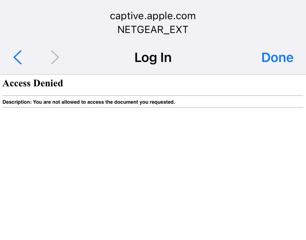

Ethernet Cable Preventing 2G Connection on AC1200 Dual Band WiFi Extender Model EX6120
I am trying to get my Netgear AC1200 WiFi extender model EX6120 to connect to my ethernet cable connection. The extender shows and connects to both 5G and 2G and works just fine without having the e...

Hi there, I did. The message I received when I selected to be connected as Access Point was:
"Access Denied
Description: You are not allowed to access the document you requested."
From there it doesn't let me make any other further changes.

It happens when I use my mobile device (I also tried to complete the setup on my PC and it was unsuccessful). After I select the AP option, attached is the message I received.
When I follow the instructions you posted, ie. having the ethernet cable plugged in while in set-up, it does not want to open the set-up window. It connects to NETGEAR_EXT, but it does not open the window for set-up. The message I received happened when I plugged the ethernet cable during set-up (at the AP selection point).
