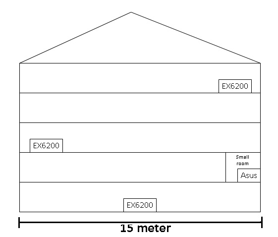

How close are these together? You're running 3 ap's plus the main router. I'm curious how much area you're trying to cover

There 5 floors in my building here. I having a EX6200 at ground floor 2nd floor and 4th floor. I attached a picture for better understanding.

Since you have them in AP mode, its fine to have them on seperate channels.
I would seperate out the ssids though. The EX6200 doesn't have built in mesh or support seamless roaming.
You state over 5ghz speeds are fine. Are they fine if you hard wire into the extender? I get that basically makes it act as a switch but its another point of reference.
You can also try the shutting off all extenders but 1 and then shutting off the 2.4ghz on your main router. You can turn it back on but you're going to have to try different scenarios to figure out where the root cause is.
It'll probably take some testing aka playing around. Shut off all but one extender and focus on getting one extenders speed improved over 2.4ghz. If all 3 are having the same problem, it tends not to be the extender. It tends to be a setting you have in them, the router thats hosting, or the device you're testing with.
