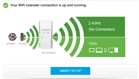

EX6250 Netgear AC1750 Mesh Extender - No Longer Works
TL;DR: After the power cutting out, my device no longer shows itself in my Wi-Fi network options for any device, even after multiple factory resets. How do I fix it to where (1) the extensions appear...

1. your photo is showing that the extender is connected back to the router fine with both channels. The "no connection" just means that nothing is connected to the 2.4ghz channel currently.

- NoightHowkJan 18, 2025Aspirant
Thank you for the response back. Here are my responses to each of your points:
(1) Good to know, thank you.
(2) I did not disable both Wi-Fi networks. Just like how I set it up initially in July, I have them merged under the same identity, but after I did that, they were separate networks to join in the Wi-Fi networks menu. Now, I can't see either in the Wi-Fi networks menu.
