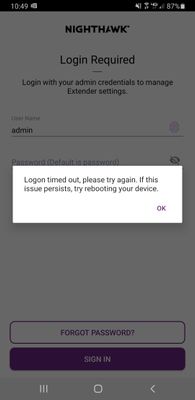

EX7500 shows on NH R8000 router but does not show connected
I am showing the extender conected to my router however it is not able to show a green light that it is actaully part of my network workign properly. I am also not able to login to the extender via ...

Jim98516
Oct 21, 2020Aspirant
Router firmware is v1.0.4.62
Extender firmware is v1.0.068_1.0.76
Hopefully the pics came through this time. The green light is in teh app Network Map that shows the internet as green, router as green and exdenter white/gray.
