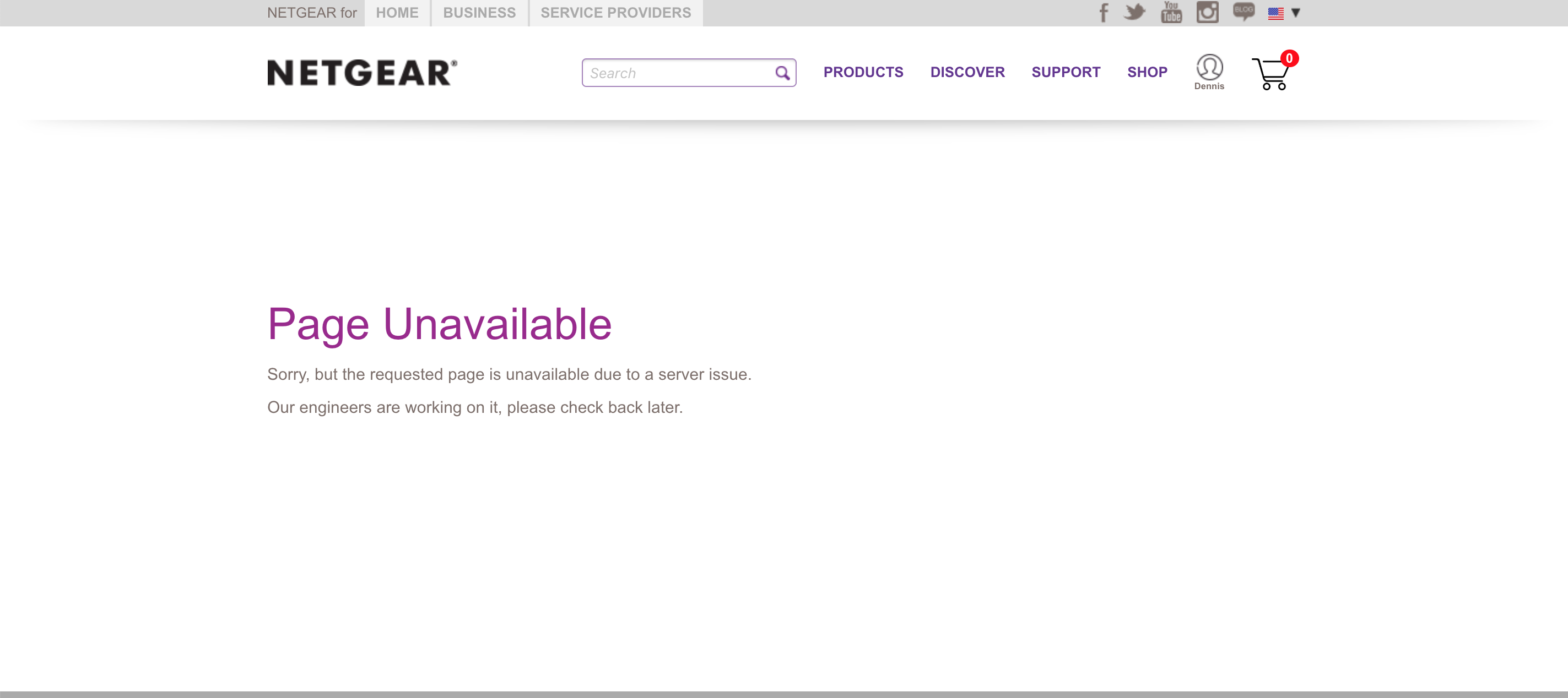

    Same here, also the R7000 itself has to be rebooted when the Ex7700 gives up, usually after 1 day. Tried positioning, updated firmware, managed channels, etc. Also when I call support I need to give the serial number by voice and that doesn't work because it doesn't recognize the letters well and I have to start over. Gave up after 35 mins. And online I get this message: cannot be reached, see screenshot.
    Bad product, no support.
