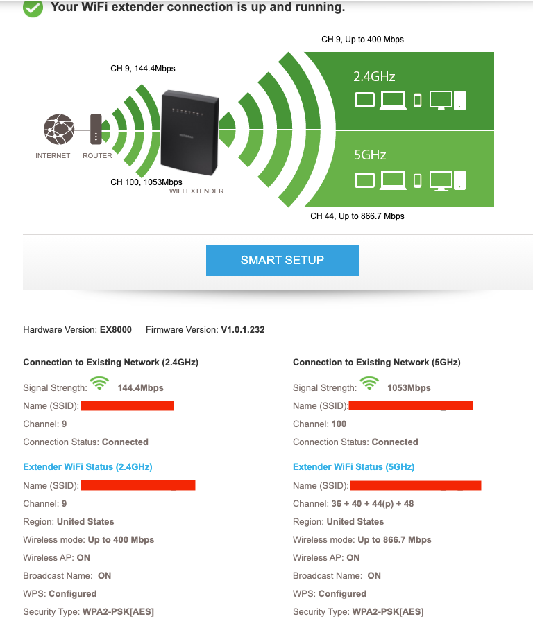

Thanks for the reply, plemax . The previous screenshot is how the EX8000 appears when it gets into this unstable state.
I did coincidentally do a factory reset today after my initial post in an attempt to eliminate some bogus configuration as the source of my issues. I've attached a new screenshot of the EX8000 after factory reset, before it gets into it's weird state.

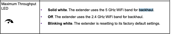

Are these what you are thinking might be going on? I've had a look at the LEDs on the front when it's in this weird state. From the manual, it says the "throughput" LED would turn off if it were using 2.4GHz for the backhaul but I haven't obseved that.

EDIT - no idea why my images aren't working, annoying. Attached one directly.
