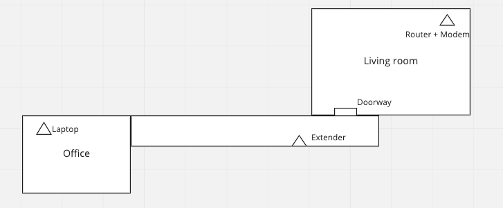

The distance between router and extender is around 20 to 25 feet. I'm living in a Victorian house with brick walls and heavy plaster. I've attached a simple diagram so you can see how things are positioned. The scale is only an approximation, but this is roughly how it's all laid out.

brick and plaster are close to 2 of the worst materials for blocking wifi.
Usually when I find people with those types of homes, I advise them to find a way to hard wire in access points/extenders.
The plaster/brick makes the wireless connection unstable and unreliable. Some can get it working but most struggle.
To hardwire it you can investigate moca adapters (ethernet over coax), powerline, or even running a few runs of ethernet (if you own the home). Sometimes the cost is offset with much better stability. Plus if its hardwired, the cheaper mesh systems (dual band mesh) can be hardwired in and function as well or better than the triband mesh systems.
But if you've got it working, great. If it stuggles with stability, I'd look into hardwired connections for your access points.
