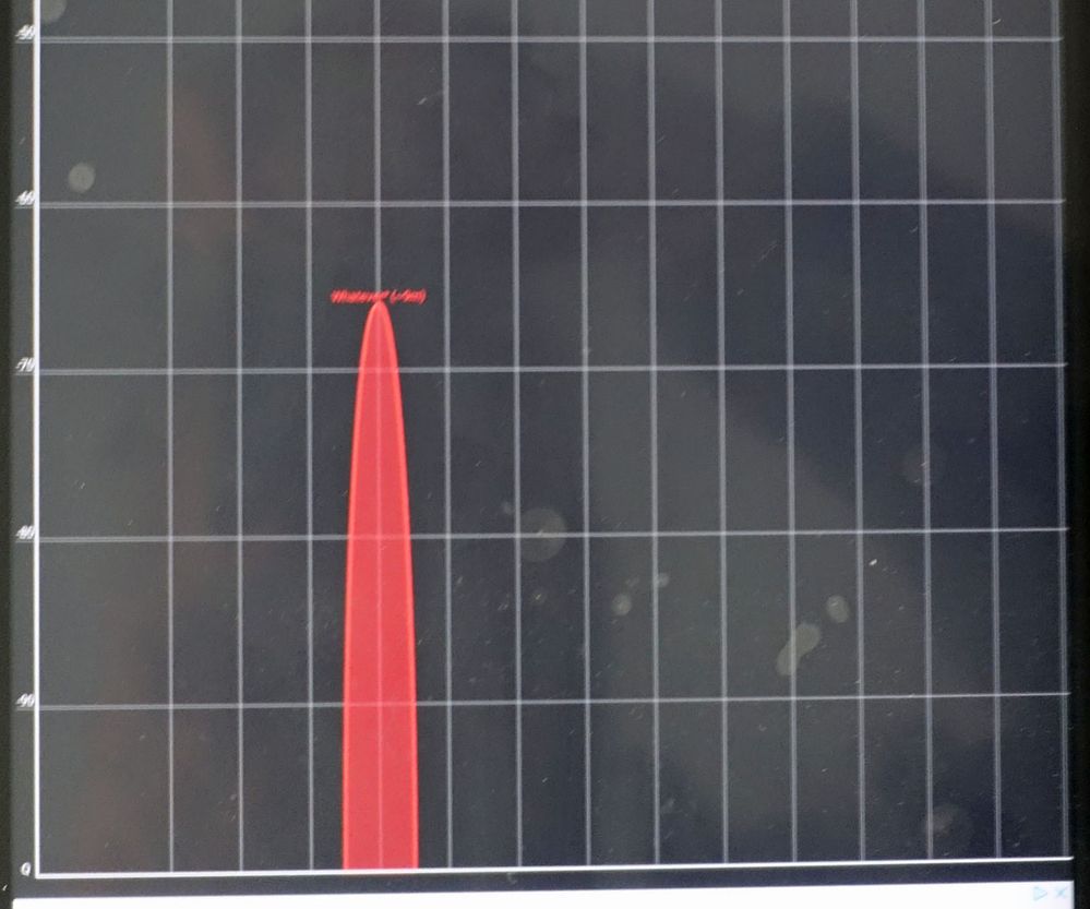

The photos are far from good but serve their purpose. Red peak shows 5G output from router (channel numbers hidden by advert). The star photo is far from pointless. It shows the 5G router output (ch48) & also demonstrates that there is no 5G boost signal on any of the 5G channels. Installing inssider would be a waste of time as my PC is hard wired, no Wi-Fi so not helpful.
The lack of 5G boost is likely to be either a setting not correctly made (no-one has come up with a likely culprit) or a faulty Netgear extender which means an expensive replacement..
It's probably time to end this topic, thanks to those who have tried to help.

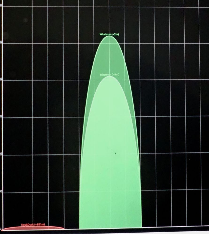

- Past-ItOct 04, 2022Aspirant
As requested, here are some jpgs for you.
NE1 2.4G showing boost signal
NE2 5G showing modem/router output only
NE3 5G showing clearly no 5G boost
NE4 Status snip
I hope this demonstrates my problem
