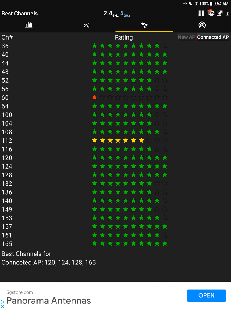

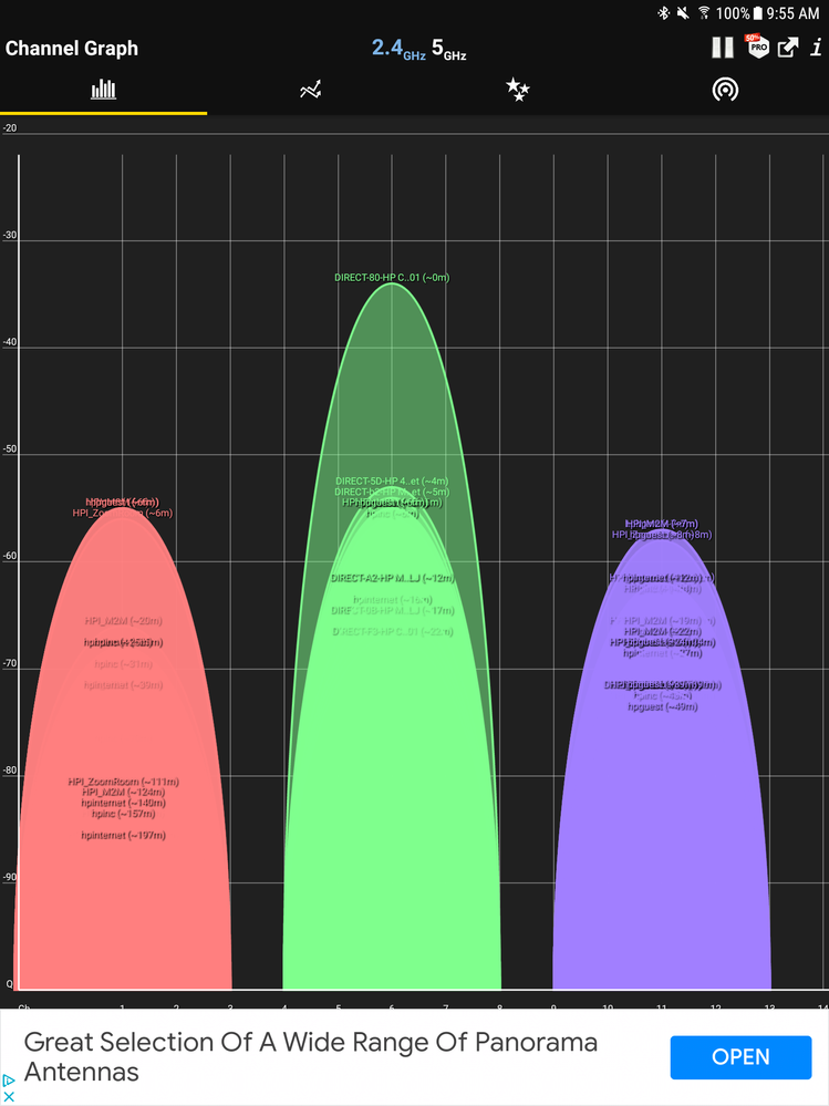

The photos are far from good but serve their purpose. Red peak shows 5G output from router (channel numbers hidden by advert). The star photo is far from pointless. It shows the 5G router output (ch48) & also demonstrates that there is no 5G boost signal on any of the 5G channels. Installing inssider would be a waste of time as my PC is hard wired, no Wi-Fi so not helpful.

Your photos leave a lot to be desired. it doesn't show the channel ranges of the wifi bands that you're trying to scan. Data is the key point.

Plus your star photo is a bit pointless. There isn't any meaningful data in it.
Try installing inssider on a pc/laptop. There's a free version of it. Then when you get it running, explore it a bit. Then take screensnips of the data. Get all the info off of it. A random, pixelated photo, without meaningful data on it isn't helpful.
I did a quick one on mine (in a basement otherwise theres 30+ networks) to show you it. And this was just the basics, I selected my network and see each band. Mine are each on the same channels because its a mesh network. Not running in AP mode.

- FURRYe38Oct 05, 2022Guru - Experienced User
To get better pictures to post in forums from phones or pads, use the screen capture feature on these devices to capture photos directly of any particular app for best clarity and viewability.
Avoid using a external camera to take a photo then posting it.
