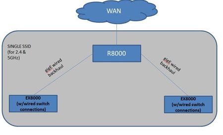

EX8000 or similar mesh extender w/wired backhaul and single SSID
I have an R8000 and would like to set up mesh extension with multiple extenders (see below) with wired backhaul.
Questions:
1) Can the R8000 be part of the mesh network also providing wif...
