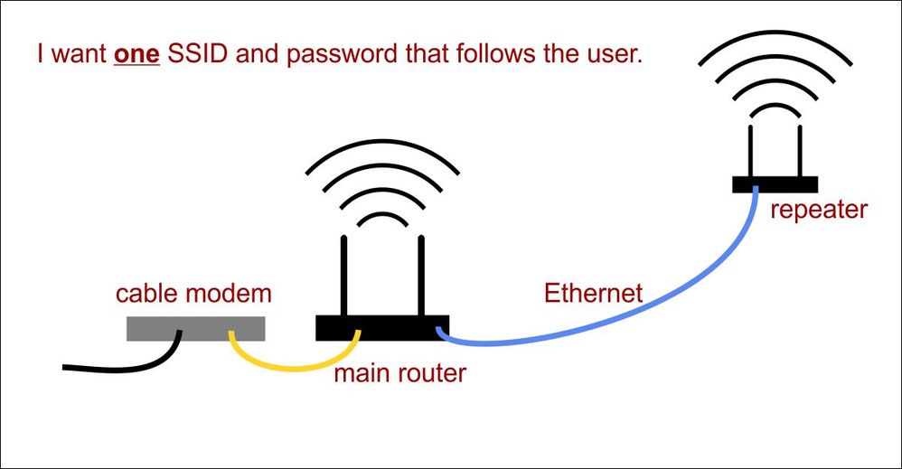

Need a device to connect via ethernet to existing router to extend wifi & keep same SSID & password
I'm looking for what I think is a wired repeater. I want to use ONE SSID and password from my main router and then have the ability to access it via wifi to other ethernet connected access points throughout the house.

  • By the description, you're looking for a wireless access point. However, you can use an extender if your needs aren't terribly intensive (like high-bandwidth torrenting and such). I've got a Netgear N300 that connects wirelessly to my router, uses the same SSID and password, and also has an Ethernet port to connect to a switch for those devices that prefer a wired connection.
    I do Netflix binging and iTunes movie rentals on an AppleTV with no issues using this method. I'm on Cox Premier (150/10) in the Phoenix area.
