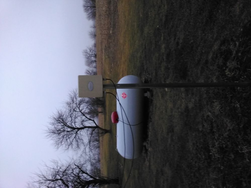

To scale the great distance I have this antenna outside.
Outdoor antenna for officeAs I said, I've been doing this for decades. Even wrote this blog post about setting it up back in 2011.

      Only solution I've found is to have external directional antenna pointing directly at the window in the house where the source can be found. What I need is an AC3200 version of the EX6200.

        You'd mount the one in the house and the other on the pole (from your blog). Then run a wire from the one on the pole into the garage and put a simple access point there. I've actually done that before when I needed to run around 500ft and it worked fine.
