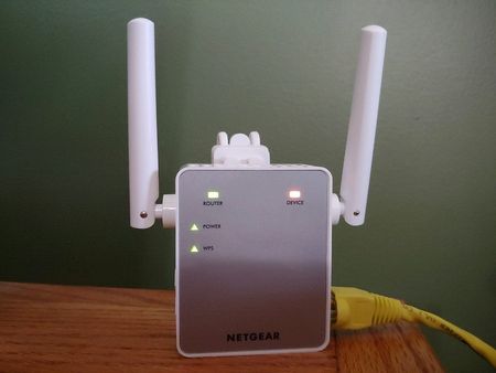

Netgear EX3700 Wifi Range Extender DEVICE light issues
Please read the entire message before you answer as this question has been asked several times before and people are giving answers that do not apply!
I have a Netgear EX3700 AC750 Wifi Range Exten...

The obvious question: Why would it stay at "best" for most of the time and just seemingly randomly drop to "poor" or even disconnect?
Would enabling Fastlane on this device help this situation?
StephenB
Sep 25, 2018Guru - Experienced User
That isn't clear to me either. A few questions-
- What device is this?
- Is it connected with WiFi or ethernet?
- how far away is it?
- Was the device moved around the time the connection dropped?
- Did some source of interference (electric motor, microwave, etc) become active around the time the connection dropped?
FastLane dedicates a radio to the router->extender wifi. It wouldn't directly help.
5 ghz has faster speed than 2.4 ghz, but shorter range. If the client device is using 5 ghz, then it is possible that it is on the edge of the range. Switching the client to 2.4 ghz could help. So if the client isn't that close to the extender, you could try disabling the 5 ghz radio as a test, and see the connection becomes more stable.
- draexoSep 25, 2018AspirantDevice is an Arris Cable modem. Connected by Wifi. It is about 30 feet line of site from the Cable modem. I was home alone. No interference... no microwave or TV. Just sitting watching the lights.
- StephenBSep 25, 2018Guru - Experienced User
draexo wrote:
It is about 30 feet line of site from the Cable modem.Well, this might not create any issues in practice. So one option is to simply use it, and see if connections actually drop.
Though 30 feet might be on the edge for 5 Ghz, especially if there are some barriers along the path. So you could try either disabling 5 Ghz or enabling fastlane on the 2.4 ghz radio.
