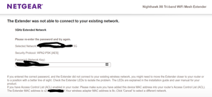

Nighthawk X6 (EX7700) cannot extend AX1800 (EAX20-100AUS) network
Hi, I'm having trouble extending the network created by my EAX20 using my EX7700. This is what I'm trying to achieve: Router Wifi ---> EAX20 ---> EX7700 (SSID1) ---> (SSID2) ---> (SSID3) ...

May 11, 2022Guide
Thanks for that. Good point about the triband. I'm not using "mesh" - they all have their own SSID. The loss of bandwidth and latency on the second node doesn't matter much to me since it is very low traffic.
My current setup is now
Router --- EX7700 --- EAX20
and it seems to work fine. Still unsure why the EX7700 refused to connect to the EAX20 but the EAX20 can connect to the EX7700.
I was told on the phone by netgear support that it isn't possible at all to daisy chain, which seems to be not true in this case.
Thanks again
