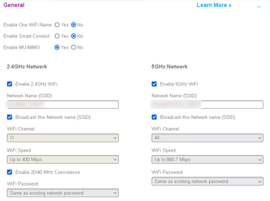

2 things to try based off your pictures that I noticed your using dfs 5ghz for the backhaul and the 2.4ghz backhaul as well
1. factory reset the extender. Reinstall it using the installation assistant but during the reinstall uncheck the "extend 2.4ghz" box.
You'll still be able to use the 2.4ghz but it won't use it as failover for if there's issues on the 5hgz.
2. make sure the backhaul isn't using the dfs channels. It could be that there's a random dfs broadcast in your area and if so, the extender and router are required to switch off those channels for a period of time. you could be getting the drops when it switches back and forth or over the 2.4ghz.

EDIT: Also, here is a picture of the EX8000 status as the connection dropped 2 days ago.
