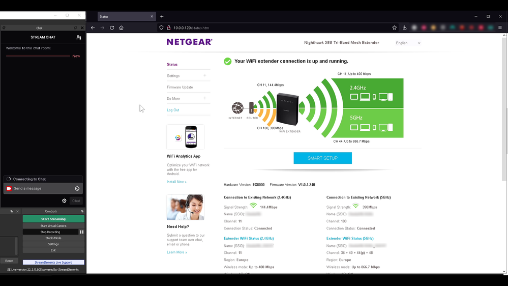

When it goes down, are you able to log into the extender and view its status page? (get a screen snip)
That can show us a couple things.
1. whether the extender is still working
2. whether the backhaul link to the router is still working

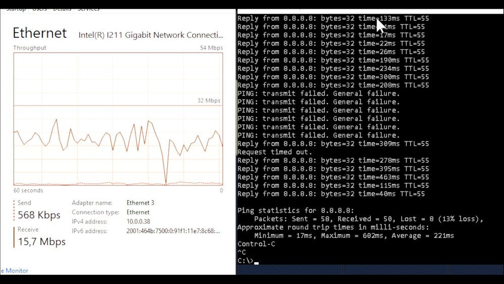

First, I monitored the EX8000 status and my network in the performance tab of task manager. I didn't see anything, the only thing that happened was that the network traffic flat-lined, and then came back after like 1-2 seconds. I wouldn't have known that it was a drop-out if it wasn't for the fact that I was purposely streaming a video on the internet to keep my network traffic above 0. I also had a twitch chat open as well, since they also need a constant connection it is easy to tell if my connection drops from the chat reconnecting. Unfortunately non of these things are new to me, and I didn't learn anything.

I decided to do a check and the problem persists.. I was thinking, if the IP lease is the problem, maybe it's 12 hours from the lease is issued, so I checked now and it seems to be the case. Exactly 12 hours on the second and this happens.
Unless anyone has any other suggestions, I will do a factory reset again with the settings you suggested. I will do this later though. I'm thinking, maybe midnight.
EDIT: Also, here is a picture of the EX8000 status as the connection dropped 2 days ago.
- plemansJun 17, 2022Guru - Experienced User
2 things to try based off your pictures that I noticed your using dfs 5ghz for the backhaul and the 2.4ghz backhaul as well
1. factory reset the extender. Reinstall it using the installation assistant but during the reinstall uncheck the "extend 2.4ghz" box.
You'll still be able to use the 2.4ghz but it won't use it as failover for if there's issues on the 5hgz.
2. make sure the backhaul isn't using the dfs channels. It could be that there's a random dfs broadcast in your area and if so, the extender and router are required to switch off those channels for a period of time. you could be getting the drops when it switches back and forth or over the 2.4ghz.
