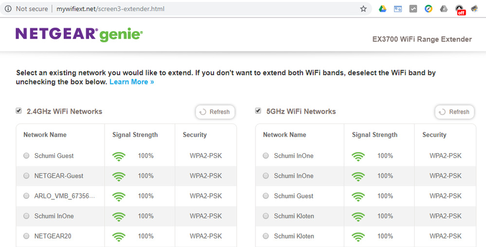

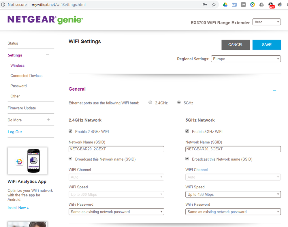

- schumakuSep 19, 2019Guru - Experienced User
Hi Wolf,
No, probably not. The EX3700 assistants are (like all newer NEtgear wireless extenders) optimized for using a single SSID for all bands - thus the same name is deployed in front of the _24G and _5G.
You might want to head to the EX3700 Smart Setup again, and select the exact SSIDs from the scan again:
In case the name is set to the same like the 5 GHz primary (root) router), head to the EX3700 Settings -> Wireless and change the configured name accordingly again:
