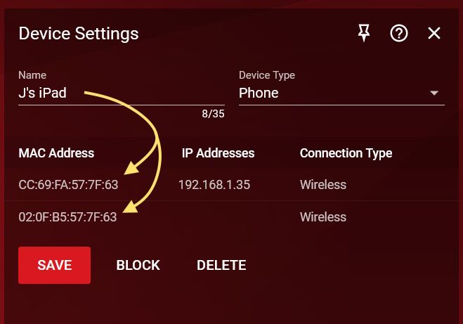

I notice in DumaOS, that a "client device" can be listed with multiple MAC addresses. So, there must be some logic that supports a 1:M schema at least by "device name" that might be formally defined an extended to the reservation table structure:

      One Mac for each IP was a great idea, but wasn't that law broken with the advent of Virtual MAC Addressing?
      Of course this is already broken. My router already shows (see my second screen-shot) a device with one IP and two MAC addresses. We are indeed already living in the mess caused by the reality of two MACs per IP.

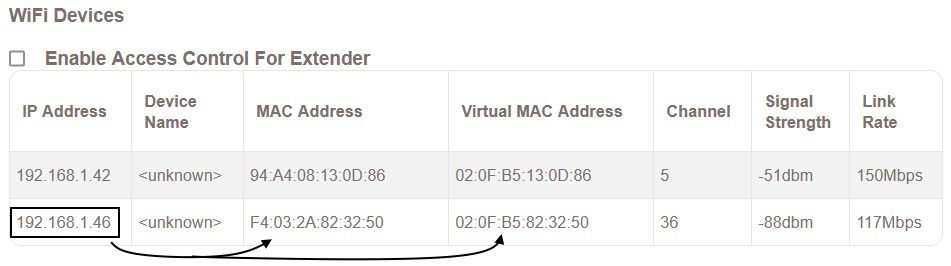

      I'm not sure how much more "messy" things could get when we already have 2 MAC addresses assigned to the same IP address?
      For example, the EX8000 shows:
      Now, what would break if the router allowed for a reservation table that had the same two MAC's for this single interface? If NETGEAR cannot share this info between the EX8000 and XR700, then just let me type it in myself and leave the responsibility with me with some words of caution. We all know that only one of these MAC's will show up on the link layer at any given moment. And, it's not like there is fencing put around every place users could mess things up on a router!
        To say it once again: The MAC translation in place on these old extender designs is key for it's operations. Sure, it does prohibit -any- common DHCP server implementation to assign the same IP address what are physically to different networks, on both sides of the extender (the wireless vs. the physical LAN port).
