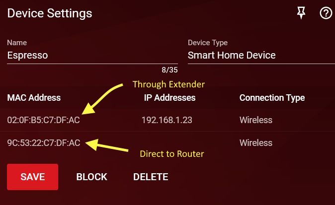

Schema of a Smart Home: One IP => Multiple MACs
I use an XR700 router with a EX8000 extender. They were expensive and I hope that they would provide my household a few more years of service. I want to use TP-Link Smart Plugs (Kasa brand) becau...

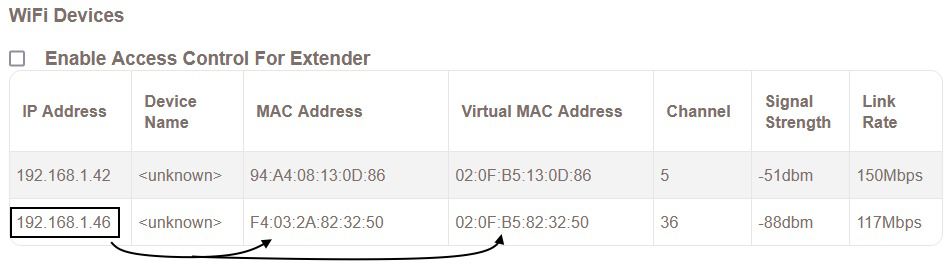

For example, the EX8000 shows:
Now, what would break if the router allowed for a reservation table that had the same two MAC's for this single interface? If NETGEAR cannot share this info between the EX8000 and XR700, then just let me type it in myself and leave the responsibility with me with some words of caution. We all know that only one of these MAC's will show up on the link layer at any given moment. And, it's not like there is fencing put around every place users could mess things up on a router!
I used the term statically-addressed which was confusing - apologies. I only seek a dynamic DHCP assignment of an IP via some IP reservation mechanism. There is no static IP option on the Kasa smart plug (I would want to manage addresses centrally, anyway) and I do not want to use a smartphone app to operate plugs manually. Instead, I want to automate an "on" command for a pump when a container is getting full using a Node-Red interface. People like to automate stuff like this and are hitting this issue and building their own dnsmasq or moving to DD-WRT or proprietary mesh rather than leveraging existing standards and asking vendor to fix what they have broken.

I would have expected that when the devices migrated back to the extender, the router would see their virtual MAC's and it did:
However, the router's DHCP service then broke its own reservation rules and provided the virtual MAC device with the IP reservation associated with the native MAC address. Wow! What is going on here?!? The router shouldn't recognize the device by virtual MAC, right?

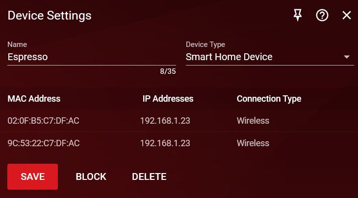

Can I count on this reservation to last? Is that why I see this entry in my client list (even after the reboot) with two MAC addresses associated with a single device, like this:

Again, down to the basics. This magic XR700 is a Netgear device, enhanced with the NetDuma code for the gaming features.
The underlaying DHCP server is the very say like on any other Netgear consumer router, with the industry standard design of -one- MAC address and -one- IP address, and built (unless I'm very wrong) based on the ubiquitous and omnipresent Busybox udhcpd DHCP. To me, it looks like NetDuma (and/or Netgear) has added this not just misleading, but technically wrong idea for supporting a single IP address with two or more MAC addresses in their gaming router Web UI.
What you experience is nothing but the RFC compliant, industry standard behavior of the Busybox udhcpd DHCP. Which ever MAC is taking preference is likely mostly random, active in the HDCP processing is only -one- MAC and the -one- associated IP address.
Back to the sender, being to Netgear and/or NetDuma, to get their pants up, ideally to remove or disable this ability to define -one- IP address with two or more MAC - simply because the Busybox udhcpd can't and will likely -never- deal with. Because it does not have to. The router behavior is correct 8-)

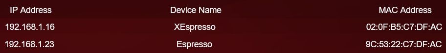

As explained, I have the following IP reservation for this virtual MAC which is being ignored by dhcpd:
192.168.1.16 XEspresso 02:0F:B5:C7:DF:AC The router is exercising this reservation instead:
192.168.1.23 Espresso 9C:53:22:C7:DF:AC So is this really just the GUI presenting the wrong world to the user or is there some undocumented stickiness found in the IP reservation system?

- schumakuApr 23, 2024Guru - Experienced UserThere is nothing overwritten. What you talk of are Locally Administered Addresses, these
can be identified by looking at the second hex character in the MAC Address. If the character is a 2, 6, a or e, the address is considered as locally administered.
This technology is used by various extenders - in this case it's MAC address translation as explained multiple times already, this design is not limited to Netgear. Similar addresses are used on wireless access points multiple SSIDs mapped to different VLANs.
Al these addresses are used on purpose, by design - nothing random: The extender does handle these correct. Just your idea on forcing the same IP on different MAC address is basically wrong. The DHCP server on the router (here your Gaming Router) - but any other industry standard DHCP server has the same limitations: By design and intention.
If you want to avoid these issues, deploy real wireless access points instead of this consumer extenders - capable WiFi mesh extenders (in full Mesh mode, not in extender mode) don't have these limitations, too.
