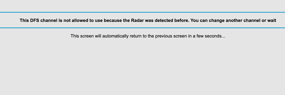

- jamieslack2000May 05, 2021Tutor
when changing the SSID on my access point to HomeNetwork-UP i get the following error (provided on the screenshot)
- plemansMay 05, 2021Guru - Experienced UserPhotos have to be approved by a moderator. If you click on "choose file" you can add that way
ah okay heres the error:
