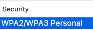

Thank you for your responses plemans ! It's strange because when I go to my xfinity settings it says I have WPA2 but when I use my Macbook it tells me that I am using WPA2/WPA3 I will insert screenshots: this is what xfinity displays for 5GHz and 2.4GHz
but this is what it says on my mac
