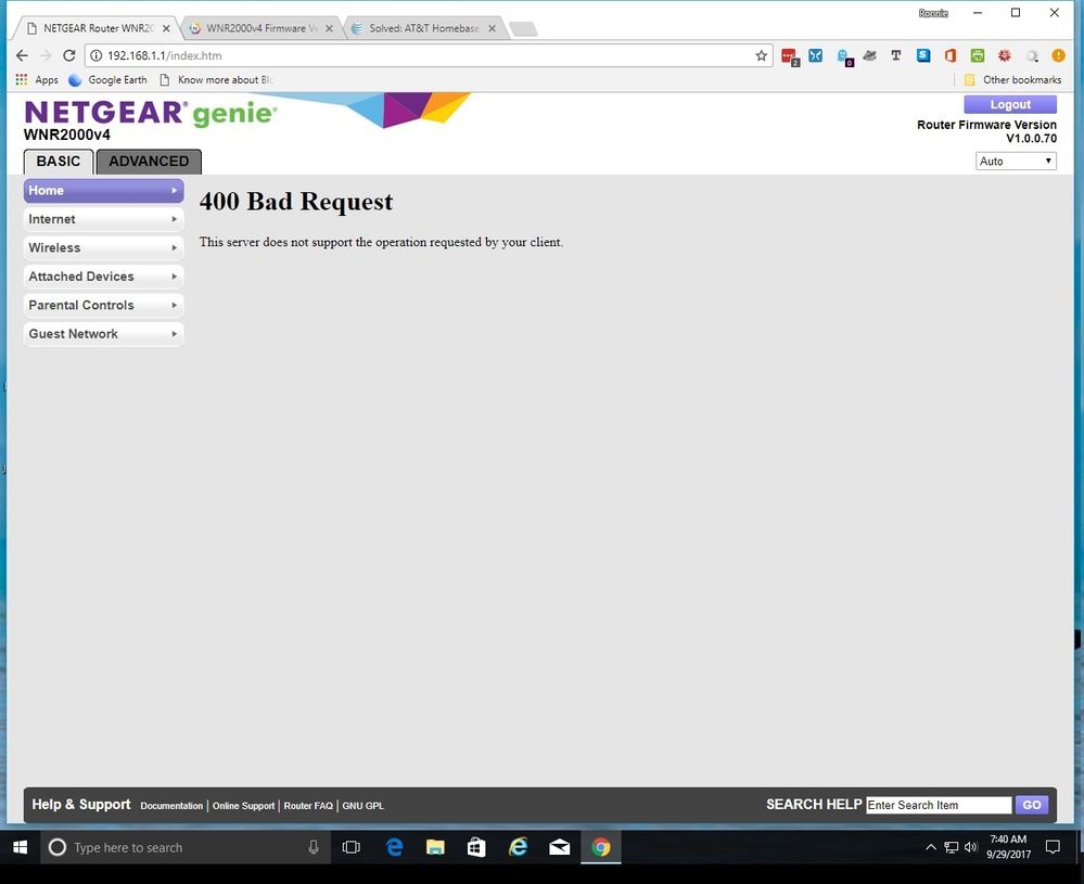

400 Bad Request -Server does not support operation after upgrade to Firmware v1.0.0.70
In prepartion to upgrade our internet service from AT&T DSL to AT&T 4G LTE Homebase, I upgraded the firmware on our WNR2000v4 to v1.0.0.70.  Since then, I receive a "400 Bad Request" message on both the Basic and Advanced home screens when trying to administer the router.  Also, the router will no longer apply/accept changes on the Internet Settings screen or run the Internet Setup Wizard.  Occasionally it will appear that the router is updating the settings (it shows a progress bar) but the changes are not applied.
The router continues to function, however, I can't reconfigure it for use with the Homebase without being able to change the Internet settings and the router isn't recognizing the new internet signal.
Has anyone else experienced this or have any thoughts?
