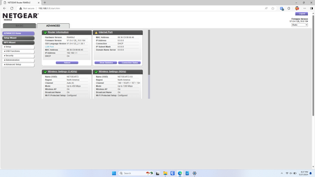

AC1750 R6400v2 No Longer Connecting to Internet After Update
I have an older AC1750 that I used to use a while ago. It has sat unused for a few years but recently I had to use it again as a temporary solution. I powered it up, connected it to our fiber ONT, an...

- land_jethroMay 28, 2024AspirantThanks for the reply!!
The ONT is a CTC Union GSW-1005MS. The ONT’s fiber link and LAN 1 lights both are amber. On the router, the internet LED is solid amber (with occasional traffic flicker).
The router was power cycled and factory reset a few times after the firmware update was applied.
I verified by checking every menu, all access controls are disabled.
The LAN cable seems high quality. It was the one given to me by the ISP. I tried swapping to different cable and nothing changed (LEDs and access to the internet and status on the router’s webpage).- land_jethroMay 29, 2024AspirantI called my ISP and they discovered an update to my service was not applied correctly, causing the service outage. It just was a coincidence that it happened right after I performed a firmware update on the router. After they fixed their end everything works.
