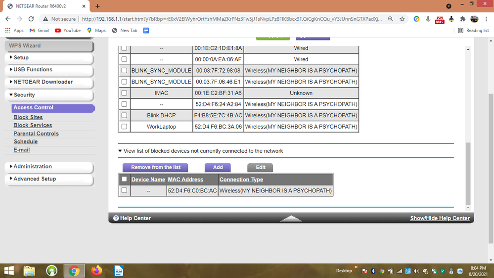

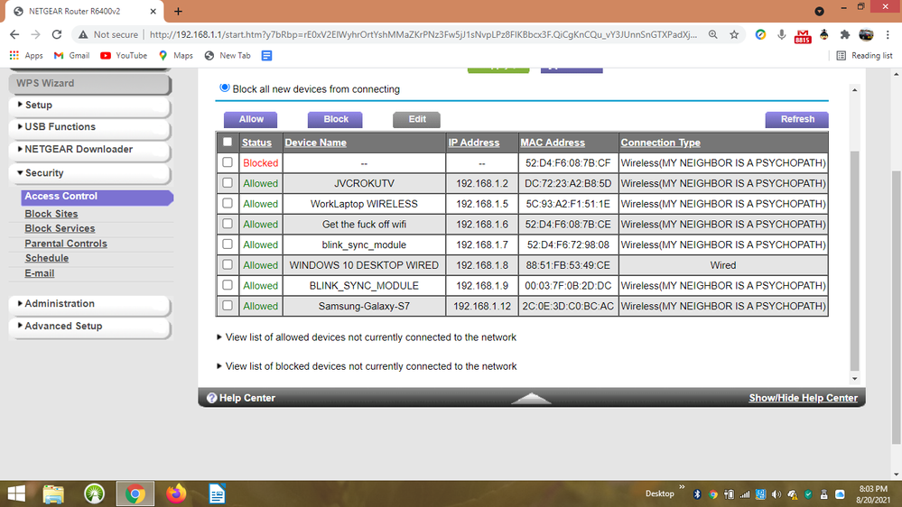

No, it has been going on for a long while and also after I upgraded the firmware still same issue. However, i reverted back to the previous version of the firmware due to the DNS resolver issuue with the latest release. attached screenshoti want to remove the BLOCKED MAC ADDRESSIT SHOULD BE DOWN AT THE BLOCKED DEVICES

Hi JGL991,
We are sorry for not being able to get back to you immediately. Thank you for sending the screenshots. Did you try changing your wireless password or reset the router? If not, please do so.
Please do not hesitate to let me know if you need further assistance.
