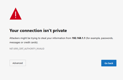

Browsers are getting increasingly picky about security.
The IP address for your AP is a simple 192,168.1.xxx, or something like that. Some browsers will reject that and won't let you get at them. They may warn that it is dangerous but offer a way around this at your own risk.
See the Advanced link.
That is in Edge. Other browsers have different ways of working.
