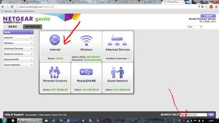

Hello My new wifi router Netgear WNDR3700v5 N600 wont connect via WAN port to internet. IP, DNS, MASK etc. is set all right.The internet connection button on router has green light. The status of i...

It was just my carelessness, I was using Netgear original MAC and ISP fixed on their device my IP adress for MAC on old TP link router...I just rewrite it and everithing start working.

I see a couple of items of concern about the Internet Port in the 2nd screenshot.
- 10.9.76.6 is a private IP address. This is usually a sign that the modem has a built-in router. It's usually not a good idea to connect two routers in series. You should either disable the router in the modem or reconfigure the WNDR3700 as an Access Point.
- The Internet Port connection type is listed as FixedIP. Unless the ISP instructed you to use a specific IP address, you should change the Internet settings to obtain its IP address dynamically.
