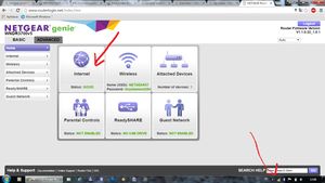

Hello My new wifi router Netgear WNDR3700v5 N600 wont connect via WAN port to internet. IP, DNS, MASK etc. is set all right.The internet connection button on router has green light. The status of i...
- Aug 11, 2016
It was just my carelessness, I was using Netgear original MAC and ISP fixed on their device my IP adress for MAC on old TP link router...I just rewrite it and everithing start working.
