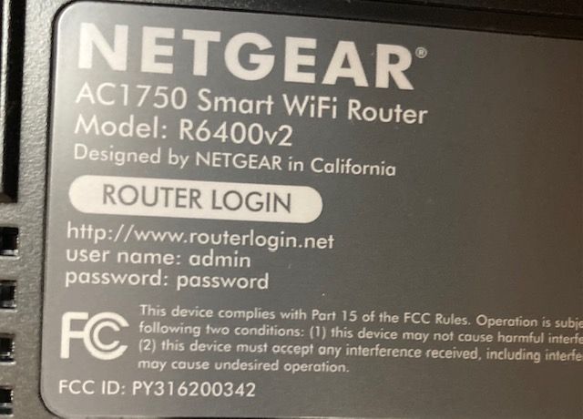

The link to the firmware is what is provided for the AC1750 via the downloads website, which is the link provided
https://www.netgear.com/support/product/r6400v2

As you were told earlier, there is no such thing as an AC1750 or AC6700 V2.
Look at the label on the thing.although that may not be correct.

You router is telling that you are trying to install the wrong firmware.

As I said, I wouldn't be confident that the label is correct.
That says your hardware is Model: R6700v2. But if your latest screen shot is to be believed, the router is running the firmware for the R6700v3.
Netgear's firmware is not transferable between hardware (V) versions. That's why they reject incompatible firmware, which seems to be what you are seeing. Trying to force the wrong firmware on to a router is a good way of wrecking it.
That your attempts to update get a "wrong version" message suggests that you have a V3 device.
So, either the model number label is wrong, or someone managed to achieve the impossible and get V3 firmware on your V2 hardware.
V2 routers need .chk files while V3 routers need an .img file.
You now have a possible answer to your original question about the rejected .img file.
