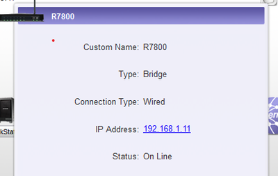

        Your first message tags the R6400. Your screenshot shows the R6050.
        The LAN Port settings you show do not look like those on my R7800 in AP mode.
        There is no need to hide your IP addresses. No one can get at them. They are local to you.

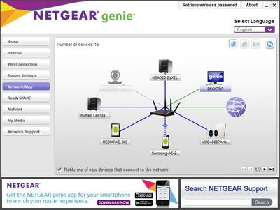

        By the way, the support pages for the R6050 are rare in that they still have a link to NETGEAR Genie App (Windows).
        If you use that you can forget about fixing IP addresses. The Network Map will show the AP and should even have a clickable link.
        Not so much a "cutesey app", more a valuable tool.
