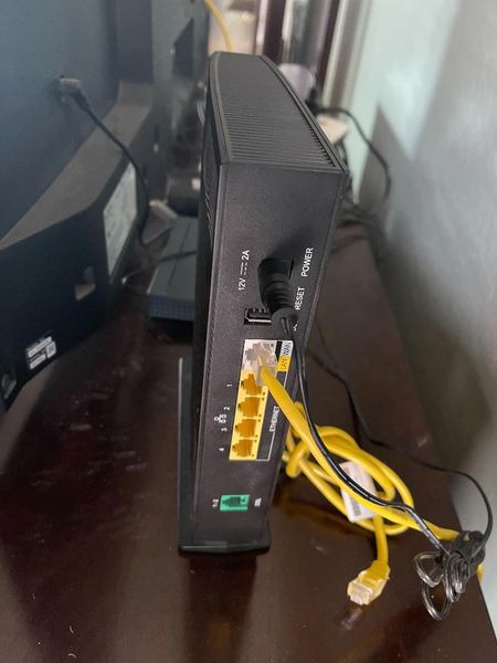

Can't Connect Orbi to Modem.
1. Can't connect Orbi AC1200 to (Centurylink) C3000A Modem. The internet feed comes to the modem on an ethernet cord . Plugged into the ethernet port titled "internet". There are 4 additional ethier ...
plemans
Feb 22, 2022Guru - Experienced User
the one from centurly link is a modem/router combo device.
it causes a double nat.
A double nat happens when you cascade more than 1 router.
https://kb.netgear.com/30186/What-is-Double-NAT
Fixes? There’s 3 options but only use 1.
1. Put the modem/gateway in modem only/pass through mode. This disables its routing functions.
2. Leave the modem/gateway in router mode but put the Netgears IP address into its DMZ. This forwards the data to the netgear. You can either leave the modem/gateway’s wireless enabled or disabled. Just make sure its using a different wifi channel to prevent interference
3. Put the Netgear into access point mode. This disables its routing functions. Wifi/ethernet still works but it does disable some features.
https://kb.netgear.com/26765/Which-features-are-disabled-on-my-NETGEAR-router-when-it-is-set-to-AP-Mode
