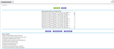

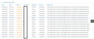

      However, yesterday I saw on my routers log that I have massive connection attempts per second (bots?) from various IP's all over the world to my NAS's peer-to-peer app on one specific OPEN port. The second problem is every 5 minutes constant there are connection attempts on NAS's admin account. The router says:
      [DoS attack: Smurf] attack packets in last 20 sec from ip [192.168.1.10], Tuesday, Jun 07,2022 18:53:13
      [DoS attack: TCP Port Scan] attack packets in last 20 sec from ip [83.20.32.56], Tuesday, Jun 07,2022 19:29:50
      Maybe this is causing the router to some kind of - 'lock itself' ?
      I am attaching the logs.

        As to DoS Attacks, Netgear's firmware is great at creating false reports of DoS attacks. Many of them are no such thing.
        Use Whois.net to see who is behind some of them and you may find that they are from places like Facebook, Google, even your ISP.
        Here is a useful tool for that task:
        IPNetInfo: Retrieve IP Address Information from WHOIS servers.
        The IP address you mentioned, 83.20.32.56 seems to be Orange Polska S.A. Is that tour ISP? You don't say.
        If these events are slowing down your router, that may be because it is using up processor time as it writes the events to your logs. Anything that uses processor power – event logging, QoS management, traffic metering – may cause slowdowns. Disable logging of DoS attacks and see if that reduces the problem. This does not prevent the router from protecting you from the outside world.
