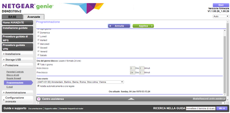

Hello everybody, I cascade Netgear DGND3700v2 to a modem of my provider (LAN to LAN). I followed this steps: 1) Adapt DHCP range (for main modem in set from 192.168.0.2 to 192.168.0.254 and its ...

There is no way to set manually time?
And for the other problem what is the solution?
Thank you!

You're using the router in a way it was not intended to be used, So it has limitations, when WAN port is not connected time won't sync, and turn off WIFI via schedule won't work either.

My purpose was to use ISP Router as simple modem, to access to Internet, while the Netgeat to manage the home network. There is no way to do a similar configuration? Neither Lan to Lan or Lan to Wan connections could do this?
If I use my Netgear as access point it is very limited (as functions)!
