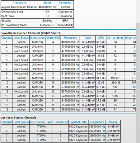

CM500 Not Locked Chanels
plemans
May 01, 2021Guru - Experienced User
Your power levels are way out of spec and some aren't locking.
You should be between -7.5 dbmv to 7.5 dbmv. You're way under that. Plus you have a lot of errors in the channels that are locked.
Check the line for splitters or attenuators and remove them.
check the line for kinks, damage, old/bad/corroded ends and replace them if you do.
If possible, move the modem to right where the coax comes into the home to prevent wiring in the home from being the issue.
Then try it.
If you still have issue, your isp will nee dto check the line.

May 08, 2021Aspirant
