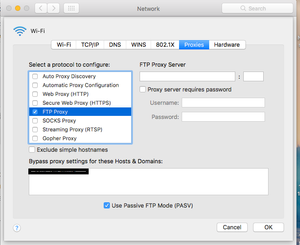

Hi, Extremem frustration here. :( I am trying to transfer some files from my website via ftp and cannot get it to connect via Filezilla. I'm not very technicial and have done what I can. Attached is...

Hmmm. That's in passive mode (Settings > Connection > FTP :
Transfer Mode)?
My FTP experience is almost exclusively with old/insecure FTP, not
this fancy new stuff with TLS, so I know nothing, but it's clear that
communication up through the initial handshaking is working, and then it
goes bad after you get authenticated. (Presumably, you'd get an error
message if you put in a bad password, which might be interesting.)
My expectations would be low, but you might try extending that
20-second timeout a little (60s?) to ensure that the server's not simply
too busy to respond promptly when it tries to locate your home directory
(which it should do after it accepts your credentials). (Settings >
Connection : Timeout)

Thank you for your relpy. I made sure all of the log on information was correct. In addition, I contacted the host that I am trying to connect to, in order to transfer files and they were able to make the connection.

- LisaMKAug 25, 2017Aspirant
Thank you, it worked!
