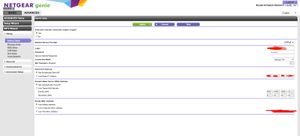

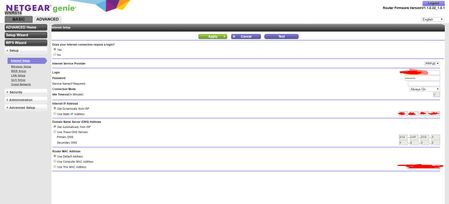

So why is my screenshot not getting approved? And yes, I did exactly what's said at page 20. My modem is a Optilink(provided by the ISP) not sure about the model though. Modem is perfectly fine as it automatically connects with other branded routers.
I'm still suffering from the problem though. I have to manually connect to the internet everytime I shut the router down. Does Netgear routers even have this feature of connecting automatically to the internet? Somebody pls help.
