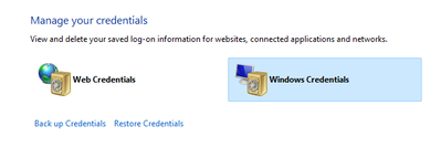

If you open the Credentials manager you can show the windows credentials then make the password change required, you'll see READYSHARE as a generic credential, change the password within that and voila you'll be able to use your Readyshare drives, works for both the USB cable attachments correctly.
So that is the solution to the problem caused by not being able to access your drives.It's nothing to do with adding old broken network solutions like SMB 1.0 or WINS, as long as your network is set correctly it should operate succesfully.

Open Control Panel in Windows 11; hit windows key and r type "Control Panel" and it will open the only control panel in windows change your view to your choice and open Credentials Manager, from that chose windows credentials and you can make the necessary changes using that.
That has given me access, once again, to my NAS readyshare drives attached to Windows 11.
What are those necessary changes?
- 222Graham222Feb 15, 2024Guide
