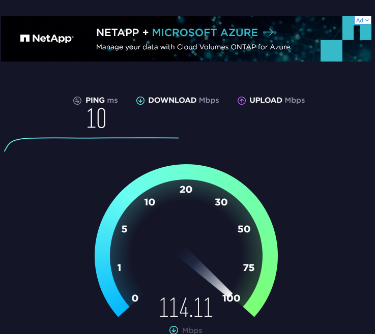

So one more quick update before bed - I just setup a DLINK DAP-1650 Wireless AC1200 in AP mode - after completely factory resetting my Arris modem, after the LED WiFi incident mentioned above.
I'm back online at the moment and my WiFi is working and my connected / wired PC is working.So here is what is left in this big mess of things:
