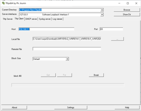

jnr1010v2 firmware got corrupted
model: jnr1010v2 n150 wireless router. firmware got corrupted while updating because of power cut in between. I downloaded jnr1010v2 firmware, but not getting installed. please help to get firmwar...
plemans
Nov 09, 2021Guru - Experienced User
You can try recoving it with tftp or nmrpflash.
are you on windows? if so, follow this guide
https://kb.netgear.com/000059634/How-to-upload-firmware-to-a-NETGEAR-router-using-Windows-TFTP
just make sure you enable tftp
https://www.thewindowsclub.com/enable-tftp-windows-10
and here's a video walk through using a tftp client. Use the built in one for windows 10 though. the video is more of an example of how its done.
https://www.youtube.com/watch?v=R9DLrLQrpaw
and if that doesn't work, you can try using nmrpflash
https://github.com/jclehner/nmrpflash
