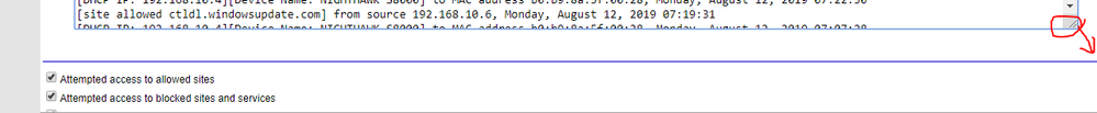

When viewing the logs on the router interface, the width is limited to 57 characters on my system.
1. is there any way to make it wider so that each record takes up one line ?

    A very strange default for the Web UI Logs view - you can adjust it manually with your mouse/pointer by dragging the edge of the logs frame bottom right...

      1. thanks, hadnt noticed the expander, and it works fine
